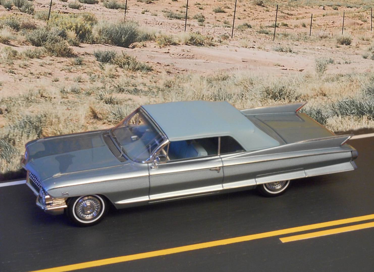

Hello eveyone!
Here is the closed model already presented...
151087 2 1
The car hood is placed a little too high as we see by comparing it with the real model:
02 1522698516363@2x
We see also that the front quarter windows are much more tilted back than on the miniature.
So i got to work...!
Here is the car with lowering of the roof, i added rear side windows and a finish with BMF.
DSCN0312
DSCN0316
DSCN0315
DSCN0327
DSCN0348
DSCN0345 (2)
DSCN0334
DSCN0303
ROTATION (2)
DSCN0320
DSCN0319

Domi @domi7777 - WoW!ย  ย Tres bein fait! ๐Ÿ˜Žย

@domi7777ย
What was involved in moving the windshield?

@jcarnutzย
I will try to answer your question by showing you my way of operating. ๐Ÿ™‚ย
I removed the top of the car and i will temporarily take off the rear window to avoid any unfortunate skkiding of the cutter.
DSCN0284
The 2 rear bases of the top are planed to lower it by 1 mm; for the front, it's trickier but doable because the crossbar at the top of the windshield still retains some flexibility to be tilted backwards without damage.
DSCN0286
To still be able to accommodate the amount of the windshield under the top and avoid a "cap" effect, i then had to cut almost 2 mm wide on the inside front of the top.
To ensure a solid bond,i used super glue that i spread sparingly on ONLY the 2 bases of the roof; for the final assembly, light pressure on the front part resting on the top of the winshield will keep the horizontality of the roof.
