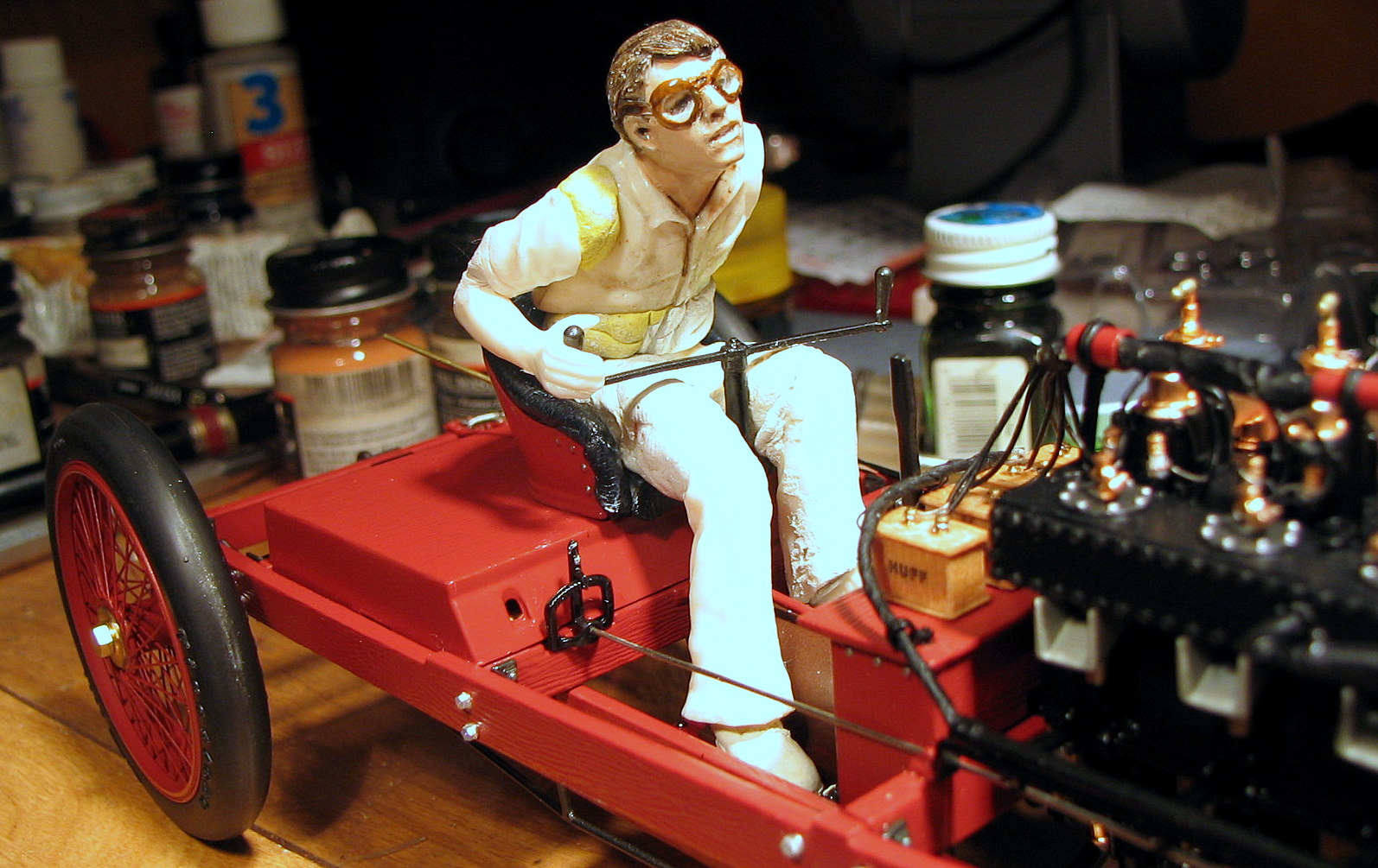

The vision was a driver hunched over, head up with both hands on the tiller and feet angled to rest on the brake and the accelerator. So I don't have to completely sculpt it from head to toe, there numerous scales accessory figures with various heads, torsos, arm and legs on trees optimally in styrene. Here's an example in 1/24 scale:
H61TEMP 108
H61TEMP 091
H61TEMP 098
Starting with construction below the belt line, the easiest way to position legs and feet are to wedge , heat and reposition. For the feet to meet the pedals, remove a wedge just above the top of the foot and to stretch out the legs (on a lower body part that's in a seated position) Cut a wedge behind the knee (with a razor saw) heat if necessary and  straighten the legs to meet the pedals. The wedges can be filled in with a type of A+B epoxy putty. I also used the putty over the legs to create blue jeans.
Exoto 056 001
Exoto 057
At this stage, I took a stock torso with head and repositioned the head to  face upwards becausethe torso will be leaning forward. I did a rough painting of the head to see how it would look and fabricated goggles from scrap styrene softened with liquid styrene cement which acts like a solvent.
Exoto 054 001
Exoto 055
I then mated the torso to the lower body with a bit of shaving and temporarily held them together with removable museum putty which also allows subtle movement of parts before a permanent fixation. As to the arms and hands, they had to be treated like the the legs and feet to mate with the torso and the tiller handles.
Exoto 059 001
Exoto 060 001
Exoto 066 001
Leaving the upper and lower tacked together, as the intact figure can't actually be inserted in one piece, I could now finish and paint his shoes, jeans, leather jacket in epoxy and lead foil collars belt and cuffs. And I topped his head with a backwards peaky newsboy cap of putty as a brass shim brim.
Exoto 063 001
Exoto 069 001
Exoto 070 001
Exoto 071 001
Exoto 073 001

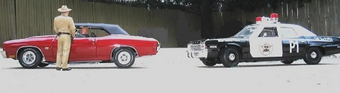

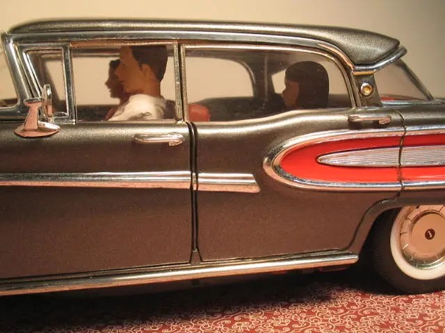

That's true, occasionally I've fitted 1/18 models with "augmented figures"  that I've re-worked to fit.    Mine don't match Rich's level of detail, but you get the idea.  😉
Here's just a few examples:
ED 7
Ed 4dr 3
Ford Big Job 7
Ford Big Job 3
Ford Big Job 2
MHS 6
Cad accident 4
Olds 59 8
Olds 59 9
Police 3
Police 3b

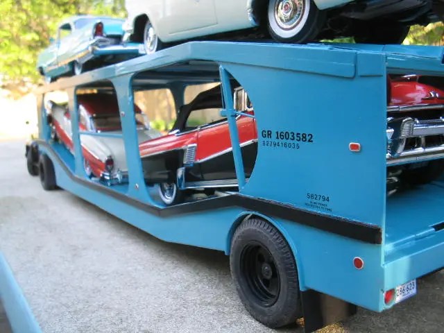

@rich-sufficool Thanks... that was my part of my first 1/18 hauler project - which was featured in a magazine and about 300,000 times online.  Years later, I completed a second one - which garnered even more attention.    I'm thinking of another (in 1/18.... but I've done a few in other scales too ).
M4
MHS 1
MHS 10
MHS 7
MHS F 800 Done 2
Ford Big Job 11
MHS 9
MHS w Merc
COE 56 and MHS 53
COE 1
COE 2
COE 3
COE 4
COE 6
COE 7
COE 8
COE 36
Ford 57 M2 hauler
Ford 57 M2
MHS 3
MHS 4

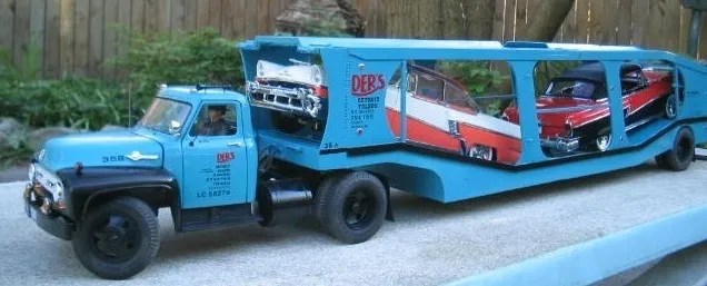

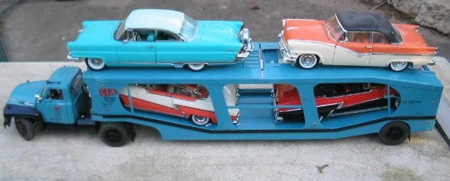

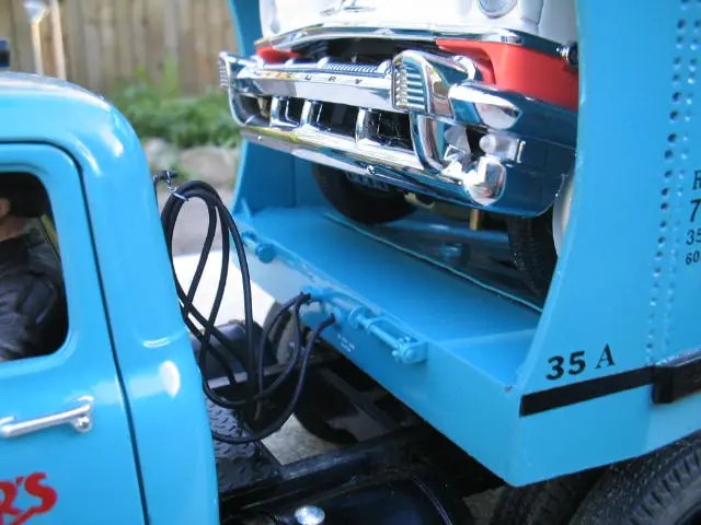

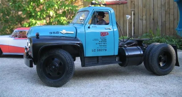

Posts: 27481
Chris, your haulers and their loads are superb. The attention to detail is beyond words, the wheel covers taken off and the windows rolled up get my attention.
Posts: 24048
@bob-jackman Thanks Bob!  Both of those "side-projects"  were a PITA!     Each window had to be cut-to-fit, then frames had to be fabricated, then those had to be chromed!  😳 😳 😳
The rims had to be a scale 14" (Ford used 14" rims in 1958 ) and 99% of 1/18 steelie rims are scale 15"
So...... I had to custom make ONE (which was two pieces ) then make molds and cast SEVERAL sets!    😬 🤪 😩
NOTE: Each Ford ALSO has a box of scale 14" wheelcovers - that fit perfectly on those 14" rims - in the trunk!   (SEE PIC )
COE 17
COE 12
COE 11
Resin cast 3
Resin cast 1
Resin cast 5
Resin cast 2
Resin cast 23
COE Resin cast 6
COE 10
