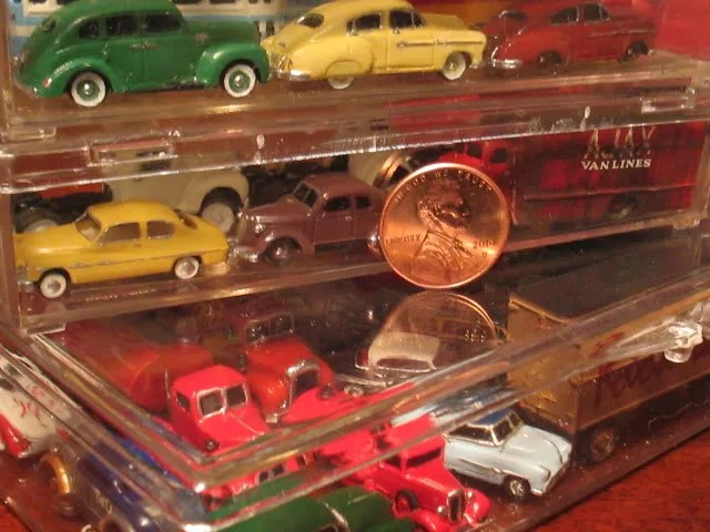

Like Geoff, I too use CHROME (or Gold ) markers, then blunt the tip onto a non-porous surface (plastic or glass ) then with a tiny brush I'll apply the paint.    TIP: Marker paint dies fast; you must work quickly and/or prepare for "numerous bluntings."
But it will dry "Chrome."     Notice (poor pic ...I realize ) the baby-moon hubcaps on this green N-scale Ford.   Those were painted over 40 years ago using "Chrome maker paint."
